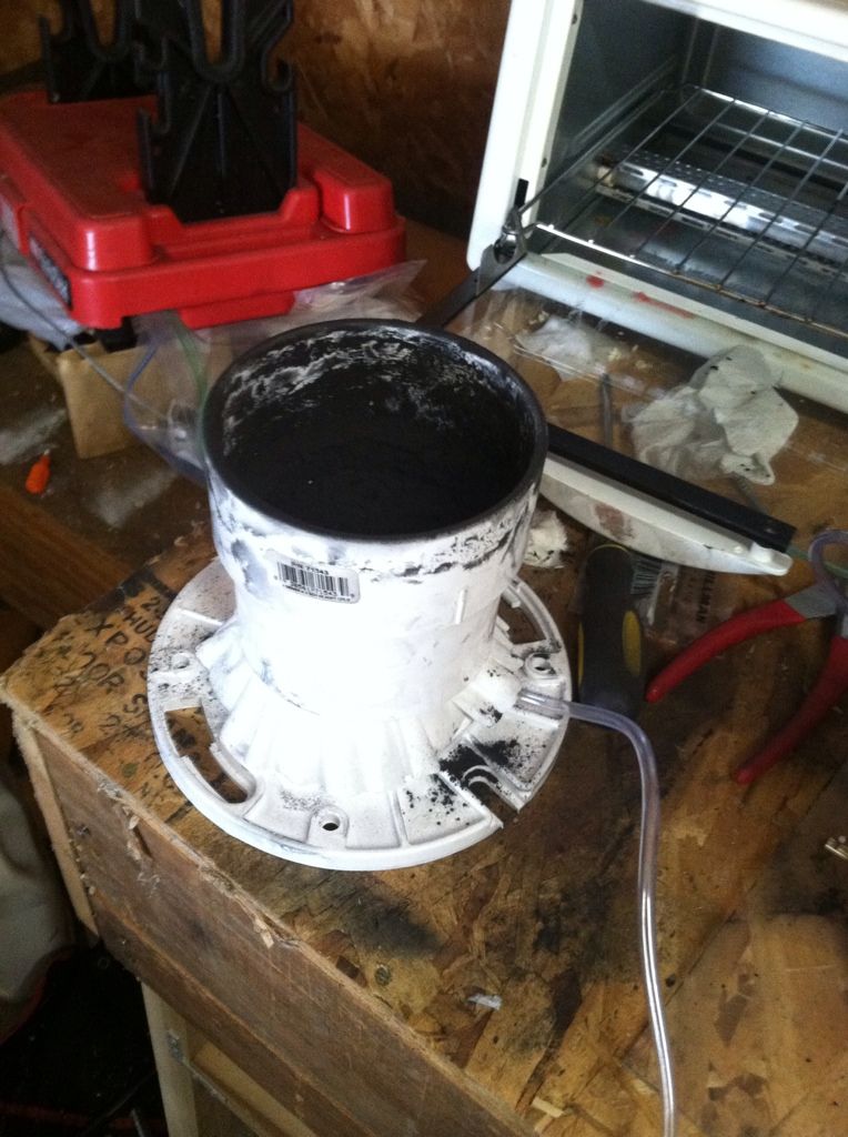

little up date, started the test how to do the coating stage, I have the powder coating gun coming in, more like setting on the local terminal floor.
since I am also casting and reloading for 9mm and 40s&w. using the 9mm as a test platform. I am also using a fluidize bedding system to coat at the moment.
made some mistakes on this, did not clean them before coating, used alox, and cured at too high of a temp. the pencil cup work well, next set I make, I am going to clean the bullets and just preheat them.
just gotta figure out the right number of bullets in the cup or come up with an vertical hold system. some do have a nice bronze color to them lol.
the system I like
added a 4" coupler to the top to add a little more powder once I get some more.
you maybe able to cast 6 boolits, put them in the cup, dip, shake a little just to roll the boolits, pull out tap the powder out of the cup. drop on the baking sheet. you don't want to heat your cup up
one of my goal is to use pc to increase the diameter of the conical to allow to full oversized bores. I will still lube the boolits.

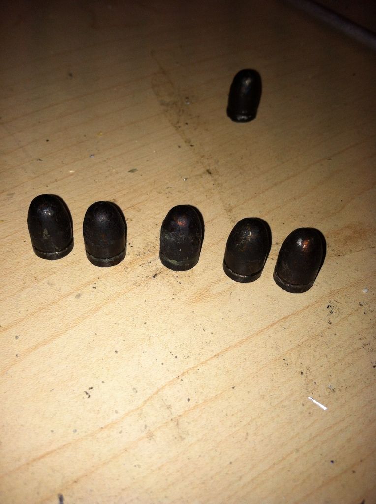

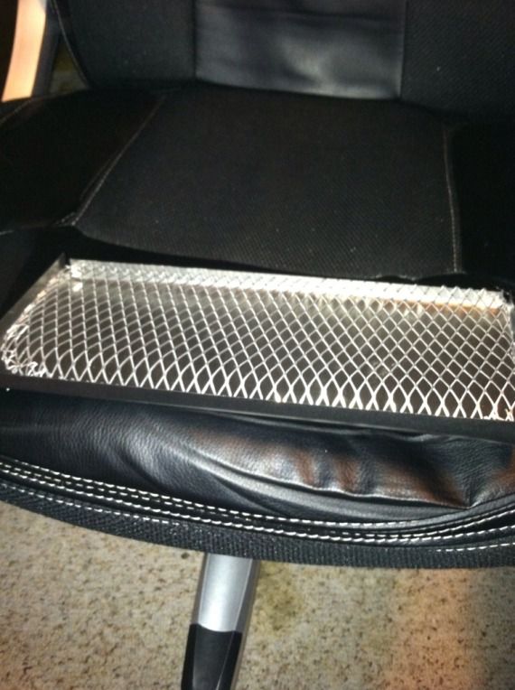

I end up buying a powder coat gun and 4lbs of powder. coated 6 lee 401-175 tl bullets. look great but my first curing rig stunk. too flimsy. could not find a coat sheet small enough to put in the oven that I have. so I made a curing set up.
the bottom is 22ga steel, the top is a aluminum grill pan cut and bent to fit in the pan I made. may end up changing a few things

went to test my custom made powder coating tray. basically, I made a mold that has rubber bumpers in the bottom to make indentations, and used plaster of paris, lined the out side with the non stick foil. did use a aluminum grid used on grills to help reinforce the plaster. don't think I need it.
those are lee 401-175 tl. the mold drops right at that with the alloy I am using. micked a set of those bullets. added .003 to the diameter.
before I even stuff a conical down the barrel of a muzzleloader I need to get the hardness of a bullet with the coating. if I a max of 7bhn, it should work. maybe a small amount of lube just to help with fouling.

At what temp does the PC melt ?
corey012778
Male Number of posts : 2309
Age : 39
Location : Staunton, Va 24401
PostSubject: Re: powder coating bullets   March 13th 2013, 12:43 pm
I run around 425 for 15mins. I know I annulled the lead. the toaster oven I am using only goes up to 15mins before it go to the hold.
most of the powders call for 400 for 20mins. figured I will cut 5mins off with the little higher temp. you have hold over from where I let it set and cool in the oven.

This batch looks much better than the first ones you coated
corey012778
Age : 39
PostSubject: Re: powder coating bullets   March 13th 2013, 1:57 pm
I used a powder coat gun on those. just waiting on my sizer to come in. should be very soon
