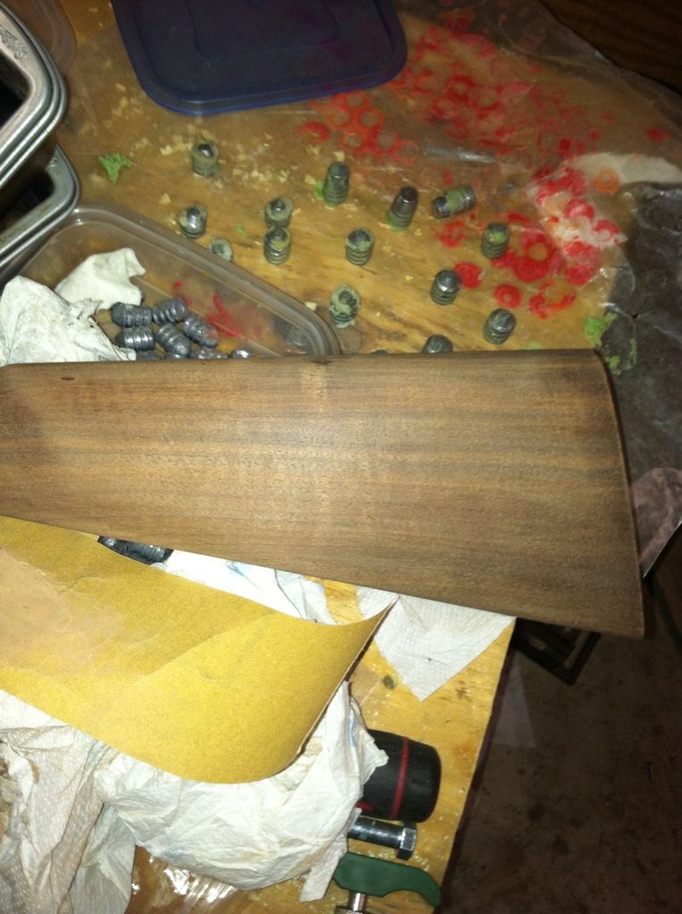

started out the night casting up some 9mm and 40s&w bullets.
pictured two night worth of casting. 88 keepers tonight of 9mm bullets. did not count what was in the bag before that.
then the rest of the night was 2 hours of hand sanding the stock to remove most of the old finish. started with 100grit, when to 150grit then to 220 grit. almost think I should just put 10 coats of polyurethane on it and call it done. lol

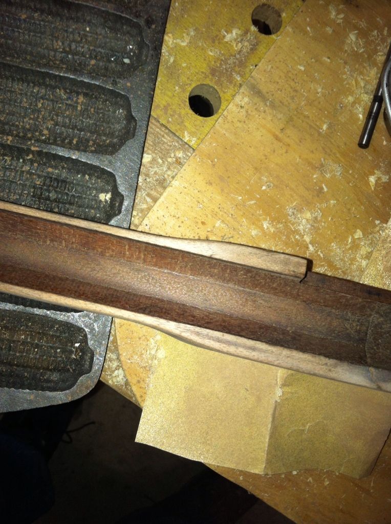

good start, I am not going to do anything to the channel until I fit the barrel to it.

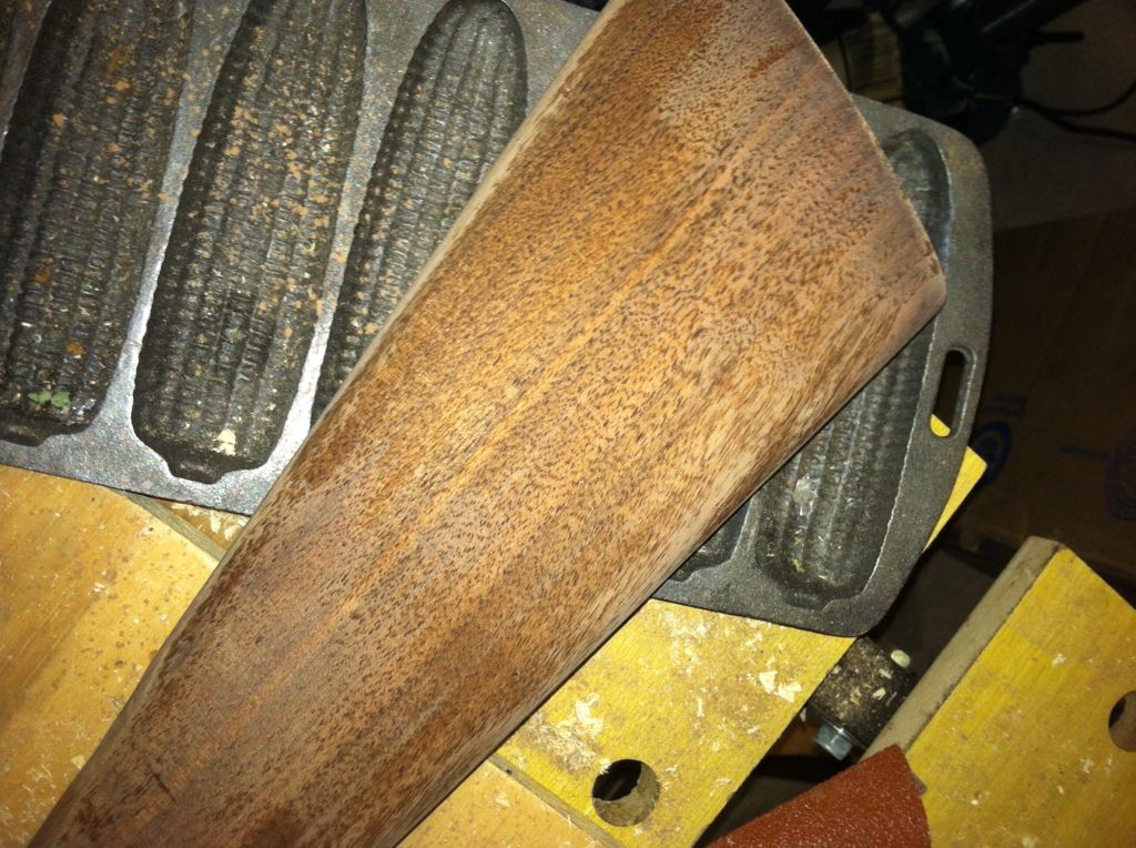

little water to show the grain that I found. not alot there from what I can see.

Good pattern in the wood. I think i would add ONE coat of walnut stain, apply very lightly. I think that would really bring out the grain and highlight it.

What's with the corn?

it is one of my ingot molds lol

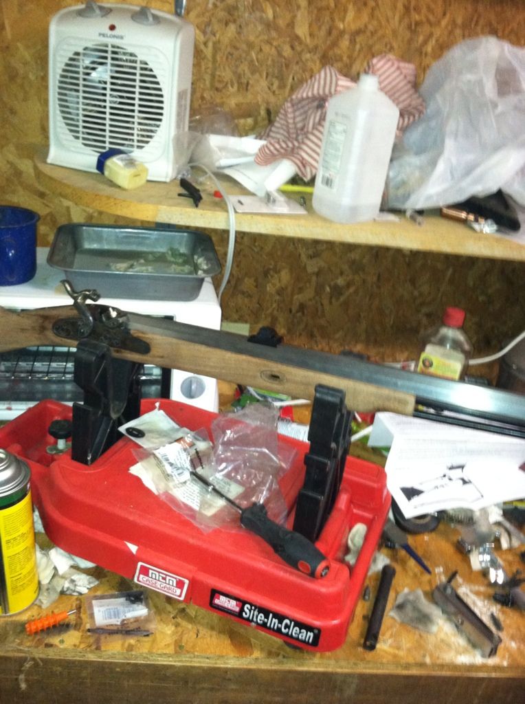

the mock up of my 45cal renegade
bad monkey  :wow
Male Number of posts : 9492
PostSubject: Re: renegade project is a go   February 2nd 2013, 7:42 pm
I see you cleaned up your work area. clown
Male Number of posts : 14395
PostSubject: Re: renegade project is a go   February 2nd 2013, 7:51 pm
That will do Corey!!
Have you considered bedding the tang and wedge key area of the stock? It made a huge difference in the tang area on my Hawken. Keeps it firmly in place and a solid bed for it to rest on.

Number of posts : 5321
Age : 51
PostSubject: Re: renegade project is a go   February 2nd 2013, 11:55 pm
Looks kinda homey Pete ...If he cleans up now some parts of his gun might go missing Wink
