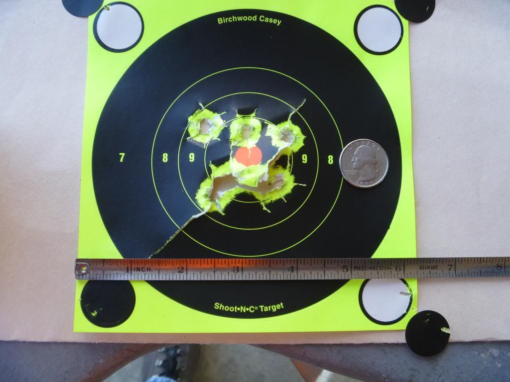

100 yds. 45-90, 500 LRN,24grns of 4227. 7 rounds  1.681 group

Looking good Joe ......load and bullet used ?

Ah silly me .....never saw the bottom of the pic  Embarassed
