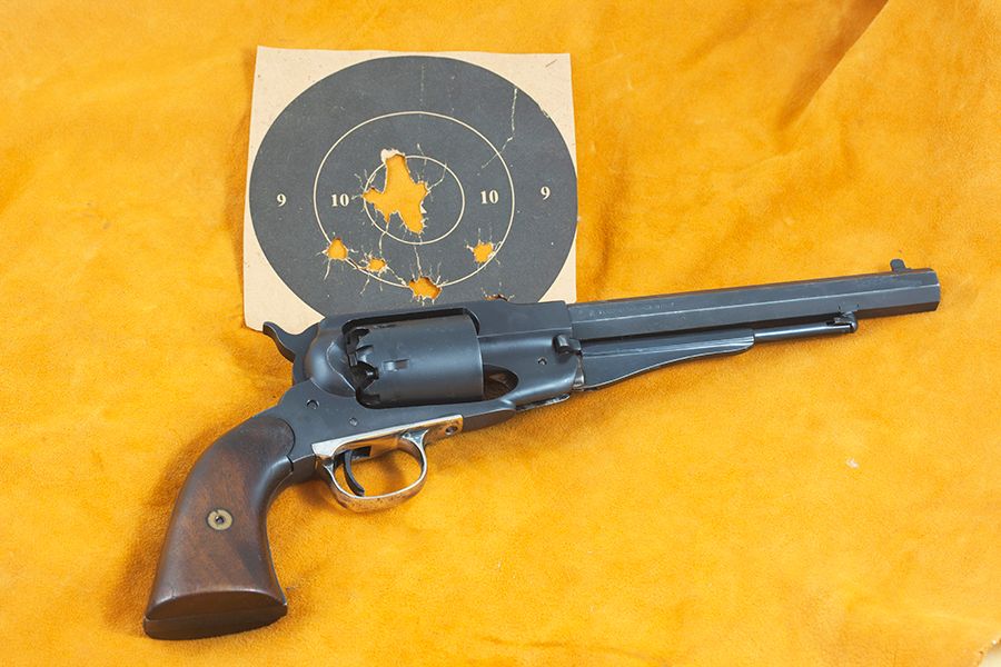

take a look at these facts, going from 30 to 15 grains does have an advantage; 30 grain loads per pound = 233 shots.  15 grain loads = 466 shots.
Most national level pistol competitors that win matches use 15 to 20 grain charges, accompanied by a filler, like cream of wheat, and grease on top of the ball. It just depends on whether the ball passes through cardboard or an animal.
This target was shot at 25 yards one hand/offhand with 18 grains of Schuetzen black powder, C.O.W., a 457RB (use only on Rugers OA & Remington Deluxe by Pietta), and axle grease.
How accurate do you want to be?Wink
