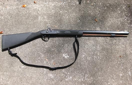

I installed sling studs and a sling on the Bobcat and then loaded it with 40 grs. of 2FG and a .490 PRB. The ramrod wouldn't seat due to interference from the screw and nut in the front sling stud. I got out the Dremel and a heatless stone and ground it down and polished it. Then I cold-blued it and coated it with RIG.

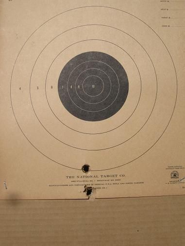

I shot the load twice from 40 yards while standing and leaning against a tree. It produced no felt recoil even though I only had on a T-shirt.
The shots were very low but grouped together. I'm going to try 40 gr. of 3FG then move up to 45 grs. and finally 50 grs. of 2FG.
I will stop if it kicks at all because I don't want it to punish my granddaughter. She didn't like the recoil of a single-shot .410 with five 000 buckshot.
If it doesn't print higher, I'll shorten the front sight.
