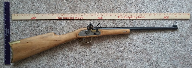

A while back I started a .22 cal flinter.  Lock mostly homemade, barrel from a 10-22.
Cherry stock.  Fun to shoot. 20gr of Goex FFFg, 21gr airgun pellets.

Now that is awesome! 20Gr of powder! That sucker is like a jet.

It does have a nice "crack".  I started with 8gr of powder but it burns cleaner with more.  Plus I need to clean after every shot or the next projectile won't go down.

I think that is really cool.  I like the way it looks.  What do you use for a ramrod, or do you just blow the pellet down the bore?  Laughing

I use music wire encased in hobby brass, soldered together, and a .22 jag turned down a bit, also soldered together into a nice ramrod, permanent.  Very stiff but not needed.  Another one same construction with a .177 jag for wiping the bore.  Then a .22 brass brush on a third rod for final cleaning.
I could force it down by air but the local range gendarmes don't like that. :-)

How's the accuracy?

About as good as a factory 10-22, not the best.
I'm almost finished with another .22 flinter.
