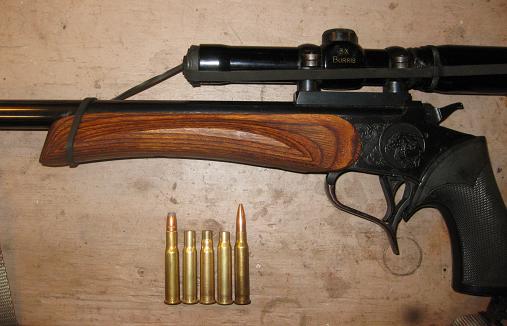

Some cases are difficult to find and have to be made by forming other common cases to the desired caliber. Some involve just shooting a live round in the gun as is the case with an "improved" cartridge. Others involve necking the parent case up or down to accommodate the new caliber like converting .30-06 cases to .35 Whelen.
Some, like the 7-30 Waters, need to be resized by necking down a .30-30 case and improved by firing the round in the gun.
Below is a sequence showing the progression from .30-30 to 7-30 Waters.
Case-forming .30-30 shells to 7-30 Waters 7-30_c10
From L to R: .30-30 cartridge, .30-30 fired case (empty), Necked down .30-30 case to 7mm in the full-length resizing die, Necked down and fire-formed case (now a 7-30 Waters case), Reloaded formed case with a 120 grain Barnes-X bullet.
Below is the T/C Contender in 7-30 Waters caliber. Not such a great rifle cartridge but a very good pistol cartridge for hunting deer and hogs. It is a better choice than .30-30 in both a pistol and a rifle due to the greater powder capacity and (in the pistol) a more aerodynamic bullet since it doesn't have to have a flat nose to avoid accidental discharge in the original tubular magazine.
Case-forming .30-30 shells to 7-30 Waters Conten10
Probably no one else on the forum is doing this sort of reforming but it's easy and mandatory if you have a gun that shoots an obsolete or hard-to-obtain cartridge.

I have been doing that for years , 8mm/06 and 7x30 waters , 22k hornet .I think I actually have 15 pieces of 7x30 waters real brass all the rest I made. Had my 8mm/06 since back in the late 60s think someone finally started mfg brass for it a few years ago. My 7x30 is a Contender also 14 in with factory brake Have shot many hogs coyotes and coons with it love that caliber.

pat', when you fire-form the case do you use a standard, reduced, or max powder charge?
Male Number of posts : 202
Case-forming .30-30 shells to 7-30 Waters Empty
PostSubject: Re: Case-forming .30-30 shells to 7-30 Waters   Case-forming .30-30 shells to 7-30 Waters EmptyApril 9th 2017, 9:30 am
Ive always been told to use a reduced load , but Ive always just put whatever load I planned on using in the case and have never had a problem. I could never understand why a reduced load would be called for if its gonna blow the case out to the chamber shape same as a full charge would.
Number of posts : 5852
PostSubject: Re: Case-forming .30-30 shells to 7-30 Waters   Case-forming .30-30 shells to 7-30 Waters EmptyApril 9th 2017, 9:35 am
I reduce it by 10-15%. The case before improving has less volume. If you use a max load, pressures could get too high.

patocazador, the pressures will actually be reduced by the fire-forming process. The pressures needed to force the shoulder forward and the case walls straighter will alleviate some of the backthrust that would be pushing against the breechface.  It is recommended to reduce loads for fire-forming but if you want a fully formed, sharp shouldered case, use a standard load and a heavier bullet than you planned on... say 140 gr.

I load for my two 7-30 Waters and never could see the need to waste bullets and powder when fireforming. I take my 30-30 brass, run through the 7-30 sizer, load regular loads that I hunt with and shoot silhouette with and use them. I have killed more deer with fire forming loads than not and they shoot just as good, ever on the steel shoots that I never wanted to waste good bullets and powder.

I have a 35-30. Shoot a 30-30, then run the case through the 35-30 die. I found it less expensive to get 30 caliber balls or even wax "bullets" just to get the case to fire form.
