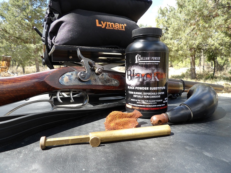

Finally got out and shot the hell out of my dads St.Louis Hawken!
Alliant Black MZ & New Patch Test 100_2479
I was testing 2 new patches, Muzzleloader Originals in .015 and .020 thickness with a .490 round ball.
I am sad to say that this patch brand has not been good to me. At 70 grains Black MZ, holes and tearing started to show up with a so called .020" patch. After this, I switched to their .015 patch with 80 grains Black MZ, accuracy increased to a small degree, but the patches I recovered were badly charred or had major blow by signs like BIG holes and ripped in half.
Tomorrow I plan on testing some factory lubed patches and we will see if the results are the same. As of right now, I would not recommend this brand of patch.

You have traditional gun patches balls clothing and caps. Whats this Black Powder substitute doing in that picture? Gets some REAL black powder.

I've told you guys before. Why burn up good black powder for target shooting when it costs me $25 a lb and a 4 hour trip?
I get this stuff for $10 a lb and pick up a few every other trip to the doctor. Save the real stuff for hunting.
