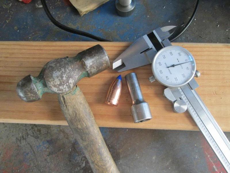

Tools needed:
One small light weight hammer
One 3/8" 8mm socket "Matco 8mm shaft DIA is .449"-.450"
Thor Bullets of course

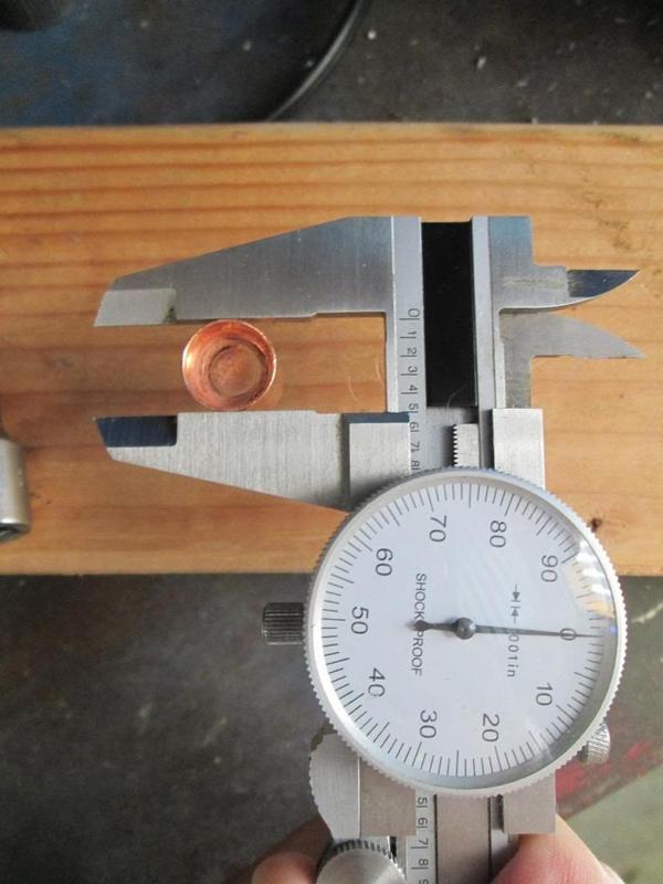

Caliper or Micrometer to measure bullets diameter
Custom sizing Thor Bullets IMG-1665-zpsa6c99bad
Now lets say you ordered .502" Bullets, but some of them as you found, just slide right down the bore very easily while the others take the recommended 20-30 lbs seating pressure. All is okay now! You can easily resize those looser fitting bullets to the size your need, and IMO this is the perfect way to get the exact size you need.

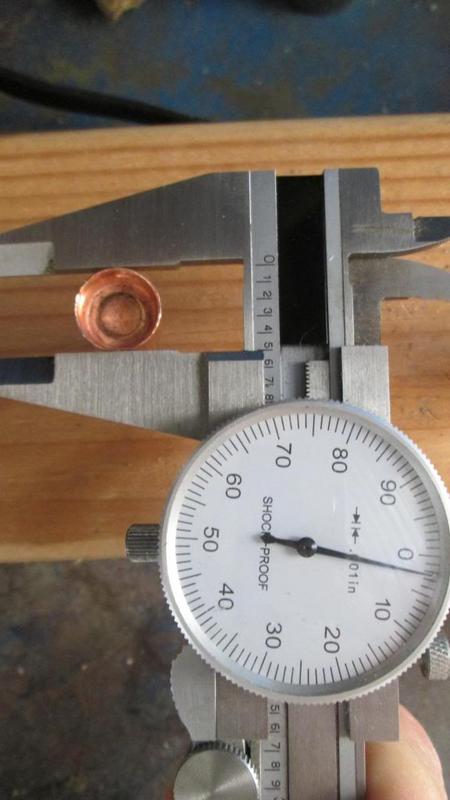

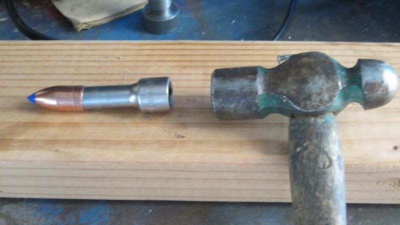

Today, I shot up the last of my Thors in my Traditions and all I have in stock are .500" Thors in 250gr Ballistic Tip. I decided to take a few pictures and share the process just in case you ever run into an undersized bullet in the package or simply want to take it up a level and size your own Thors for your bore. Quite a few on here knurl pistol bullets to fit their bores so they can shoot sabotless, this process is quite a bit easier because there's no knurling, just flaring up the base of the bullet a touch and measuring the diameter of the base and flare it up to where it needs to be for your bore size.

Get the idea?
I hold it in my hand so I can feel the amount of power I am hitting with.
After a few light taps with the hammer and I was where I needed to be.
