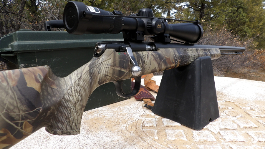

What the hell! I felt like making some smoke with the ol Winchester X-150 today.

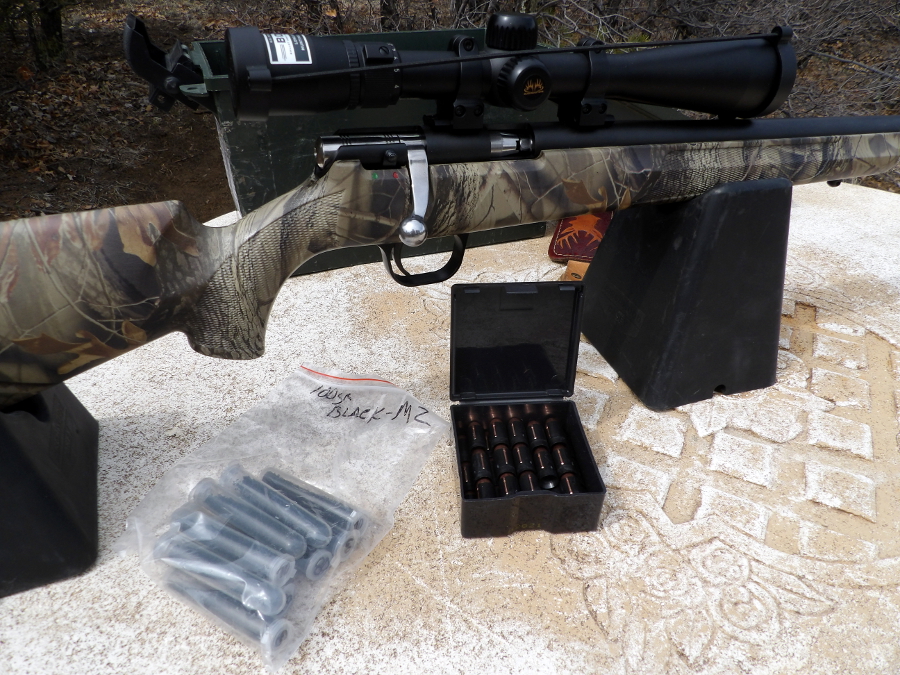

Trying out a new hotter load with the 300gr Speer Gold Dot sabots. I use Traditions EZ Load sabots with the .451" bullets. CCI Magnum Primers were also used as they are all I have left and do a fantastic job without leaving much crud behind in the bore. 100gr Alliant Black MZ Powder was used and the sabot was firmly seated on top.

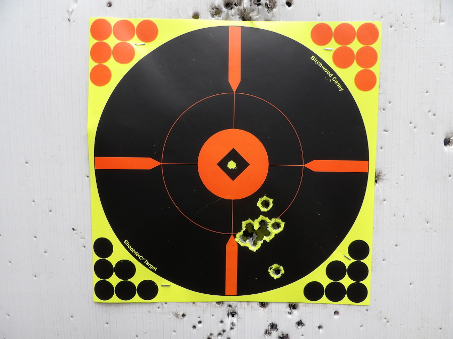

Next 3 shots were right in the bullseye and grouping great! OR SO I THOUGHT!
Winchester X-150 - 300gr Speer Gold Dots  100-3166
Next, I decided to do what I hate the most... Swab between shots... I just aimed at the corner edge of the orange and took my first shot, then used that as my aiming point from then on. First 3 shots, Swabbed
Winchester X-150 - 300gr Speer Gold Dots  100-3169
5 Swabbed Shots total,

Same load, 100gr Alliant Black MZ, Traditions EZ Load sabots, .300gr Speer Gold Dots, CCI 209M primers.

I did swab between each shot with a damp patch. There were 2 occasions however, and these 2 shots will show up easily on the target, where I actually ran 2 wet patches down the bore to really clean it out well. It did not like this at all and threw both shots out of the group. After that, I wet a patch and squeezed the living heck out of it until it was just damp.
Black MZ is very sensitive to bore condition, especially on a completely cleaned bore.

The large hole contains 7 shots, the other 2 shots, one high, one low, were the shots where I fully cleaned the bore of fouling and these are the results.
