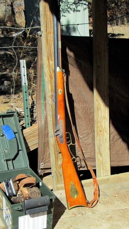

Alright, Since I screwed up that last post on this one, Here's the fugly CVA Hawken with a cheater sight option Deadhorse
Hawken #6 build Pix594551351
Not sure of the twist just yet, but the bore looked great and I ended up getting it. Looks like Monday will be the day I get to unbox her!
Looks to be a solid rifle overall. They added sling studs and someone actually got smart and used the nose cap to house the forward sling stud so that it is in a comfortable position.

What's the nose cap made from, Jon? If it is pewter, that stud may pull out over time unless it's a bolt-type with a nut rather than a wood/metal screw type.
That nose cap placement is unusual. Most Hawken copies have a barrel that's long and heavy. This usually makes the barrel top-heavy where it won't "ride" nice on the shoulder without wanting to rotate around and point downward. Putting the lug on a ferrrule allows the gun barrel to stay upright.
It all depends on the barrel's length and weight whether that placement is practical. Without the scope the balance point will shift forward.

Nose cap is brass.
I just picked it up and wow its a hell of a lot nicer than the pictures above! The scope mount is solid too. Bore looks great as well.

I MUST check the twist on this one! I shot this today with the horribly crude factory sights at 50 yards and using the fence line as my rest. Bore loads smooth and fairly easy even with the .020" patch.
80gr Goex 2fg
.490" round ball
.020" patches Lubed with Birchwood Casey Muzzle magic cleaner.

Allright, I decided today that I will keep this barrel. It is a 1:48 twist and I'll rebuild it as a plinker to drop into my .58cal Hawken Stock when I just want to have a little fun.
This rifle will now come with a brand new 1:66 .50cal barrel that I already have browned and am just waiting for the rear sight to come in. Ordered a new Hickory ramrod for it as well.
Just gotta take a little break and then its restoration begins.
