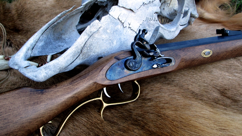

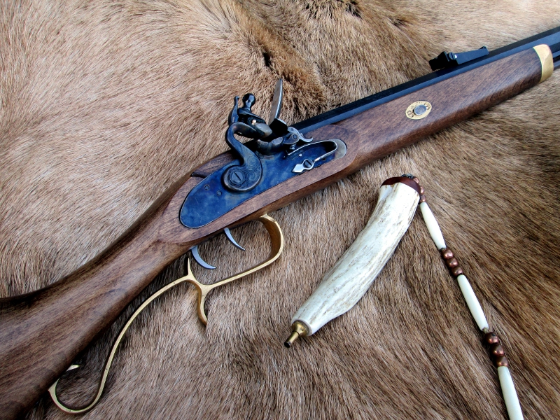

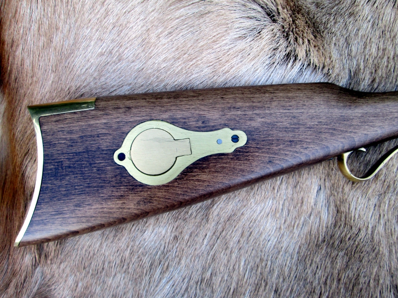

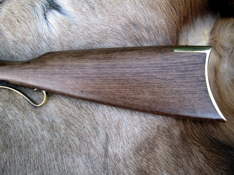

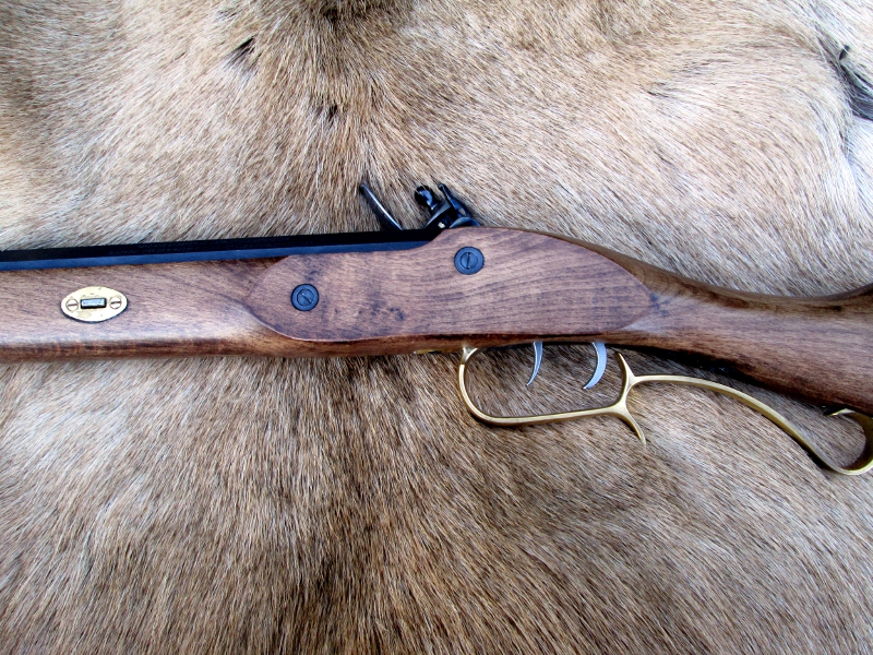

After checking over the rifle, I admired its nicely stained and finished Select Hardwood (Beechwood) stock, richly blued barrel and the crisp operation of the lock and triggers. The locks mainspring is very heavy duty. The brass was nicely polished, even though I am not a big fan of brass.

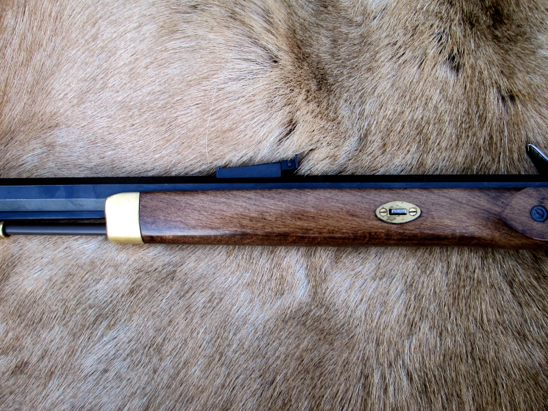

The rifle utilizes click style hunter rear sight with a round front bead.

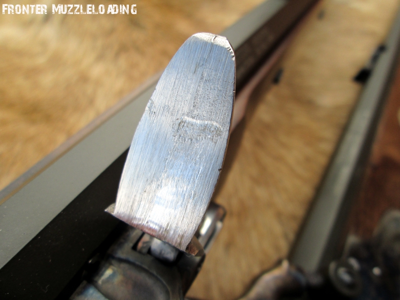

One problem I did have was with the frizzen spring. The spring was very stiff at around 8lbs to open. A spring this stiff caused flints to break within a half dozen strikes due to the frizzen not being able to fully open.
 I fixed this issue by using a small C clamp and gently compressing the spring a little at a time until I got it to open at around 3lbs which worked out perfect.

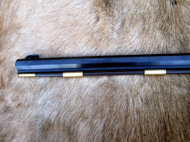

The barrel on the Hawken Woodsman is 28" long and 15/16" across the flats. The bore is superbly smooth and loads like silk. I never experianced a torn patch from a burr or sharp rifling at the muzzle. The bore measures .499" lands and .503" grooves. Tight bored but a very nicely machined barrel and one that shoots Patched Round Balls with solid hunting accuracy with its 1:48 twist. Bore Size:  .499" Lands - .503" grooves
The weight of the Hawken Woodsman on my electronic scale is right at 7lbs 6.5oz.
The rifle balances nicely aprox. 1 1/2" forward of the wedge key.

PostSubject: Re: Traditions Hawken Woodsman FLINTLOCK Review   Traditions Hawken Woodsman FLINTLOCK Review EmptyMarch 12th 2016, 10:56 am
While butchering the hog, I started cutting up the opposite shoulder where I thought the ball might be trapped. I was right!
The .490" 177gr round ball penetrated both front shoulders, completely breaking the actual round bone and I recovered the ball in the meat.
The recovered weight is 169.6 grains.
Traditions Hawken Woodsman FLINTLOCK Review IMG_6847
Male Number of posts : 1545
Age : 80
PostSubject: Re: Traditions Hawken Woodsman FLINTLOCK Review   Traditions Hawken Woodsman FLINTLOCK Review EmptyMarch 12th 2016, 11:03 am
Well, that round ball surely did the job.
Sharpsman
Sharpsman
Male Number of posts : 525
Location : Clear Lake, Louisiana
Registration date : 2016-02-13
PostSubject: Re: Traditions Hawken Woodsman FLINTLOCK Review   Traditions Hawken Woodsman FLINTLOCK Review EmptyMarch 12th 2016, 11:25 am
Way to go! cheers
Thanks for the photo!
